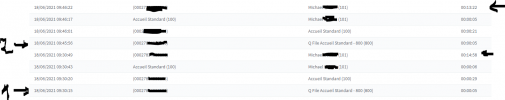

on Latest V16, on cloud OVH hosted PBX, with supported trunk OpenIP, customer indicate foreign calls are dropped after 15 minutes.
Other calls from France to France are not dropped after 15 minutes. some example here today, first call at 9:30 call dropped after 14min58 sec, then second call restart at 9:45 ending normally after 13 minutes 22 sec
For now , case have got log on 3CX is a call from South Africa , this same number call regularly but it's dropped each time in nearly same second.

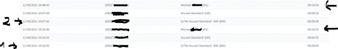

Other days exemple:
I have compared trunk sip settings with other pbx using same provider with no visible difference.
Have been in contact with OpenIP support but they see nothing strange except perhaps at the end of the call an ack not sure to be received .
Customer also noticed same behavior with luxembourg calls, so trivialy common point is foreign calls (but perhaps it's not relevant)
