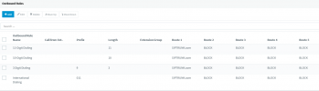

When you set up your outbound rules, did you specify which extensions they applied to? If so (if you don't have a catch all rule) you may need to add a catch all or add the ext number of the ring group to match a rule.
I have one sip trunk with 5 channels, so my outbound rules are trivial. However, they could be screwed up… Screen shot of the outbound rules attached:
How would I setup a "dummy" extension, that is then forwarded to the desired destination. I set the extension's mobile number to the destination and then set forwarding rules to forward to the mobile. Is that the correct approach? This seems to work but there are delays.

If you ever want to test if something is specific to you outbound rules, create a 'catch all' rule and place it on top. Calls starting with 0-9,+ route out of your specified trunk.
