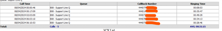

I've got a Q which prepends 444 for QCB with the associated outbound rule to remove the 3 digits.
However, when I pull a failed QCB report I get the following info.

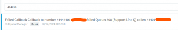

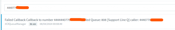

If I do a search for these numbers you'll see it's prepending the 444 twice resulting in a failed QCB.
Why is it doing this?
