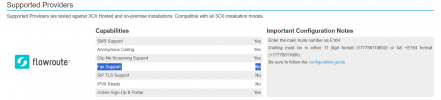

Hi @healthy fax is not listed as supported using flowroute sip trunks
if by any chance they support it then please feel free to enter in contact with them so you can configure the ATA with the correct FAX Transmission Mode
If fax in audio is used, then you may need to enable the parameter G.711 to T.38 Fallback from the fax server and restart the IVR Service, set a dedicated DID to the fax extension and use codec PCMU/PCMA as primary.
