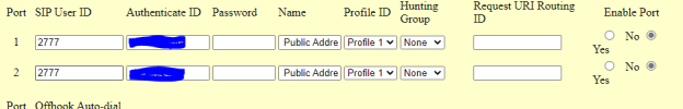

On the FXS ports page, it shows up this, which does include the extension number, and the Authenticate ID is correct in 3CX, I've manually copied and pasted the password from 3CX into the Grandstream, once I apply it, it does blank out the password box, is that by design? It is hard for me to determine is Enable Port, on Yes or No from your interpretation of my screen snip?
Please confirm that
1. The SBC IP is correct (verify with your SBC machine)
2. The ethernet cable is plugged into the correct port, like the example below:
On Chrome v104.xxxx it should appear like this below.
Use Chrome incognito mode window to confirm, because yours doesn't really look right to me.
Hold the reset button on the device for at least 10 sec. until you see the lights flash, just to be sure the reset succeeded.
