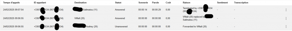

    When extension 20 is set to “Do Not Disturb,” inbound calls trigger an unexpected sequence (as shown in the screenshot below). It forward to vmail and vmail forward to an other extension. This is not the behavior we want.
Capture d’écran 2025-02-24 092919.pngCould anyone point me in the right direction to set up these rules correctly and fix the DND forwarding issue?

1. Use the department menu. Assign the DID there and routing there. Then just set the hours for it.
2. Check that the extension is not set as the Operator extension in the system's voicemail settings.
