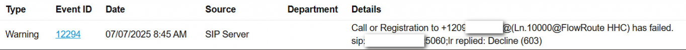

We're trying to hide our caller id when placing some outbound specific calls, nevertheless, calls are being forbidden.

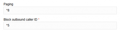

We've tried the *5 method but the call isn't going out, e.g. calling to 1 234 456 7890 and dialing *5 1 234 456 7890.
So, we tried on the outbound rules apart putting the word anonymous or unavailable, but it also didn't work.
So we decided to contact flowroute and they responded the following:
"As part of ongoing efforts to reduce fraud and improve call authentication, regulations such as STIR/SHAKEN have been implemented. These protocols require calls to contain formatted values according to the E.164 standard, which includes the full 11-digit number (1 + 10 digits). Using the correct number format ensures that your calls pass authentication checks, preventing potential call blocking or misrouting, and helps your calls complete successfully.
STIR/SHAKEN protocols state that all outbound CallerIDs must contain a valid/working phone number in the PAI: Header (P-Asserted-Identity Header). So if you wanted to mask your CID or show all calls as "Anonymous," you would still need to configure your phone system to include a number in the actual packets. And according to our records, both of these calls are missing that PAI: Header (P-Asserted-Identity Header)".

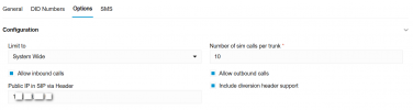

Please navigate to the options tab of your trunks settings. Do you see the "Public IP in SIP via Header" option?
If so then add your public IP to that option. Save and try again.
If not navigate to System / Updates and look for updates. Do you see the Flowroute template? If so then download it.
Hi Yianish,
I've added my public IP as suggested.
I've also checked system updates,
I dialed the star dial *5 + number and now the call goes through.

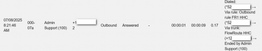

Nevertheless, I'm still seeing the Call ID on the receiver when the call is done and not the word Unknown/Anonymous or just the call ID hidden.
I tried implementing an outbound rule and putting Unknown/Anonymous but same thing that in the past, the call is being forbidden.
Should I do something different on the outbound rule? I know we're getting close, but I still don't get the desired output.
