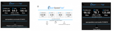

I have that doubt when server is mentioned. I requested some voip tests to all 3 extensions and results were very acceptable.
