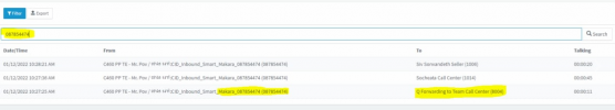

You won't need the CFD. It doesn't include the info but I did find a way to tell:
Run a call report - you can check the different reasons, and test them yourself to confirm. Busy, forwarded... will be when the extension is busy and Forwarded is when it is simply in Away status with a forward.
