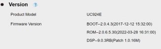

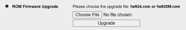

Hi @AxialTilt
Would you mind posting some screenshots of the following?
Home > Status
Management > Upgrade
You bet!
Here's the Home > Status page:
Here's the Management > Upgrade page:

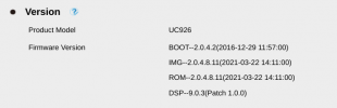

This is the phone that I tried 'downgrading' to see if it would take the upgrade. It won't. Unfortunately, I don't have a copy of v2.0.4.8.12, so I can't get it back to the same version as the other phones are, but whatever, it's close, and both versions are 'unsupported', so it's not a big deal.
Hi @AxialTilt
Ok so it looks like this specific phone does not have the "M" character in the DSP version, which means the correct file to use is indeed fw926.rom
But maybe not all your phones will be this DSP version - please verify them individually by logging into each one and checking them.
Htek has an article explaining what the difference is, please read it here to get informed:
https://htekdesk.atlassian.net/wiki...093/Firmware+upgrade+strategy+on+3CX+Platform
