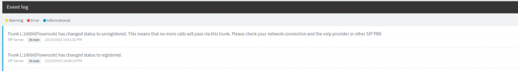

Sorry to keep adding to this but I restored from a backup from a couple days ago before this all started and saw this error
The following service(s) were interrupted: 3CXIVR01 3CXCallFlow01 3CXQueueManager01 3CXPhoneSystem01 3CXMediaServer
Any thoughts?
