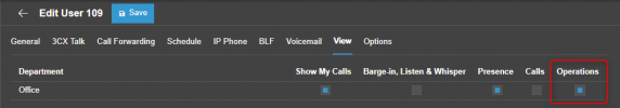

Also check that you have the users defined with "Operations" on their view tab.
You could also test with a web client on the local network. You would, however need to have split DNS setup on your network so it has a secure connection.
All users have Operations and I have split DNS. I have verified that if I use the BFL button I have sound, but not if I use *20* on the web client or IP phone. Here is the weird thing, if I use *20* it picks up the user and the person doing the pick cannot hear the end user, but if they place the call on hold and then pick it back up you have sound both ways. *20* and BFL both work for external calls in.
