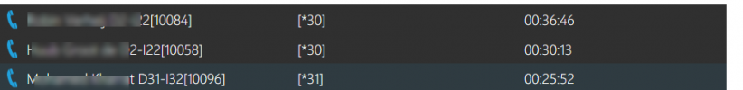

I have approximately 80 ict servicedesk engineers who log on or log of automatically from queus with *30 and *31 when the lock their screen. Most of the times this works just fine. However, sometimes not which results in this:
The call is not ended. Consequently, they have to call either *30 or *31 manually whatever is needed.
I made this through a scheduled task in a GPO which applies to all servicedesk engineers.
I have two questions:
1) how do I prevent this from happening? Can I set a maximum call time for example for this?
2) is there a better option you are aware of?
Acutally three questions :)
I hope that somebody can give me a hint
