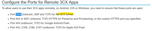

The only port needed IN to 3CX PBX for the SBC to use the tunnel is (default 5090). The SBC needs no ports forwarding but it needs a static IP.
Firewall ports are explained here
https://www.3cx.com/docs/manual/firewall-router-configuration/

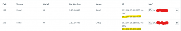

You do not need an SBC on the same LAN as your 3CX as phones will provision using LAN method.
The SBC needs to be at the remote site, your phones will provision via the SBC when you configure them this way.
they will show like this under phones tab
