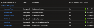

Well the main issue is that users don't sync, but with regard to the buttons, I cannot even change the radio button selection:
I see, in this case, check and make sure that the app registration for the 365 integration has been completed, as in, that you have also set the permissions in azure and switched back to the management console clicked sign in, and accepted the permissions. As per the guide https://www.3cx.com/docs/microsoft-365-integration/#h.v13e02uyuc4j.
Yes, I have done all that and gone through the guide again to make sure.

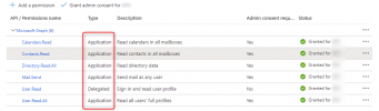

first, check the options you have set, these should be set to Application not Delegated (except for User.Read), then grant permissions again and switched back to the management console click sign in, and accepted the permissions again. Make sure you are following the guide carefully. If still an issue you can switch on verbose logging from the management console > activity log > settings and restart the 3cx system server service, then from the Activity log > Log files > Instance > download the 3cxSystemService.log. Check in this log for any errors with the 365 sync.

Well that's embarrassing, thank you! That fixed it.
