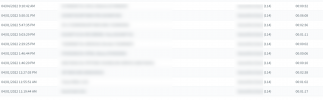

Hi Vasilis,
I ran a report for last month, x114, answered and unanswered.
Going to the last past of the report (so first day of the month), it looks like this does not match either:
It shows 9 answered calls
Out of the 9, the 2 first at the bottom were direct calls from other internal extensions, while the 7 other calls went through a call flow -> call center -> x114 picked up. It looks like the graph shows call center calls?
So I looked at the next day 04/04 where the graph shows 20 answered calls.
From the log, I see 19 call center calls, 4 internal calls, all answered.
I'm going to look at User Activity and run multiple reports (include internal calls, include queue calls) to see what I find.
Regardless, the call log above (answered and unanswered) should match ALL calls, regardless of their origin, correct?

I ran a User activity report again for last month for x114, including internal and call center calls
Then a call log report (Reporting / Call log) for last month TO extension 114
April 1st matches 9 incoming calls
April 4th shows no missed calls in the call log, but only 20 incoming calls, while the graph shows 26
Then I ran a Call reports for last month, TO extension 114 only
If I count the calls on April 1st, this only shows 12 calls (the last one in this screen shot is April 4th)
Even though I have a filter for DESTINATION x114, I also noticed that this report shows me calls where x114 is nowhere to be found. So in this report below if I only count "Picked up by xxx" on April 1st, then I found 9 calls as per the chart.
If I count the calls for April 4th, I only see 21 calls picked up / replaced by x 114 while the chart above says 26
