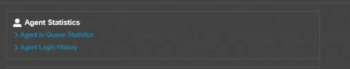

May I ask which specific report you are referring to? Agent in Queue Statistics?

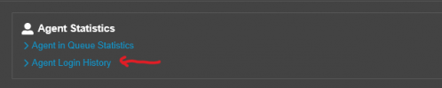

Below two reports are neither in grafana nor in the CDR tables that we are offloading from the database connectors.
Are we missing something?
The Login history element indeed does not got to the exported data. Other elements of the Agent in Queue Statistics do go, and a table/visualisation for that is possible. In the "03. Queues" dashboard the Queue Call Statistics has the basic call counts, you could expand this to be showing the durations as per the build in report, if that's what you need.

Point taken, we will consider extending the plugin queries for sure, however actually I was referring to the Agents Login History Report integration with MySQL using the API, what do you think?

At this time we are not exporting this specific information.
We wish the Agent login/logout data along with Available/DND/Away/etc Statuses will be exposed part of the data connector in the upcoming version.
Definitely these are very useful/needed KPI for the call center supervisors.
We can provide all the information you need -- log in/out times, presence status changes, etc.
