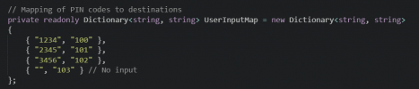

You dont really need a partner to do this!
Just download the script from the PBX store and modify the values yourself.
essentially, dialling 1234 in the example shown which is from the script will trigger extension 100
So if you want the user to dial 1 to connect to your queue (which as an example is extension 800, just put { "1", "800" },
Alot of people are intimidated by the scripts but for the basics its as simple as that!
Thats true, its really simple to implement by yourself. But anyway, i would change my partner if they answer like that.
