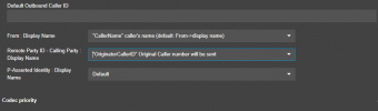

Which sip field has the provider specified that require to represent the caller id upon forwarding?
NetSIP have asked to confirm the following.
"Check with 3CX if their platform is capable to register the original callers CLI if the call is diverted from their platform."
Also, the Trunk Settings have 3 options for presenting Caller ID Header
Which is most suitable for 3CX?
- P-AssertedID
- RemotePartyID
- From
And which Option in the 3CX trunk setup should be used to achieve what we are trying to.
If your provider is taking this information from the P-AssertedID most probably this has to be configured as:
But in any case they need to clarify from which Sip field they take the information in order to forward.

I have updated 3CX Trunk config as above but the CLI is still the main trunk#

Capture from 3CX of the invite between 3CX and my mobile with settings above
If this is configured in the P-Asserted Identity what is the outcome?
Which template are you using? Is this a Generic Provider Template?
