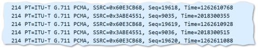

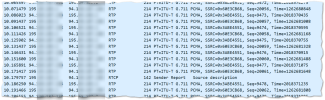

I captured packets, but I'm not sure what to look for, as I'm no SIP expert.
However, I can see lots of RTP G.711 packets flowing back and forth with calls originating externally and also calls to external numbers:
This looks to me as if the firewall is okay?

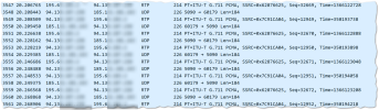

However, with the call TO an external number (where audio is fine) I additionally see lots of UDP packets in between. Could that be a STUN server? See here:
94.x.x.x is the public IPv4 address of the 3CX host.
195.69.183.2 is the address of the trunk.
What should I look for / try now?

Turned out, it was a provider problem (not of my trunk, but the provider responsible for the number itself, which had been set up by my old provider and since then migrated to my current provider/trunk).
