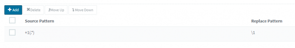

DO you know the correct inbound Caller ID formatting? I keep seeing +15556661212 and need to remove the +1
Usually, you need to have your phone numbers in the CRM in the same format as your provider sends them.
However, if you're stuck with 10-digits in Salesforce, you can go to Console > Advanced > Contacts > Options, and set this as follows:
This way, it only uses the last 10-digits of the number when doing the CRM lookup.
Reformatting shouldn't be needed here usually.
Reactions: edossantos
I need to strip off the "+1" from the inbound Caller ID or I'm not able to get a match. Tried the suggestion but no luck
If you set it to 10-digits in the option I showed, it should strip the +1 from the lookup. The Caller ID shown in the Webclient/App doesn't matter for this.
If you really want the CID to be changed, use this:
