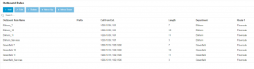

On one of our customer's systems, when I set outbound rules, the "Calls from Extension" and "Calls from Department" do not seem to work to filter which ID should be used. All extensions are getting a single outbound caller ID, whatever is at the top of the list. Is there a way to fix this or is this a known bug?
Make sure there's no overlap in the filters across the rules.
Not from what I can tell, the extension lists are completely different. There aren't any extensions in both departments.
Here are screenshots of the outbound rule configuration. This is for the US. These should not overlap at all, but something is wrong. I only posted an example, rather than all the rules. I also tried comma separating every single extension and that did not work either. I have also deleted and recreated all the rules. These rules were previously working on v18.
Version I'm using is 20.0 Update 1 (Build 673)

If it helps anyone, I was able to solve this by removing the extension lists (delete the entries in "Call from Ext." - it is back to ALL) and relying on Department ONLY for determining the Outbound Caller ID. I'm also on Update 1 Beta 2 (build 721) now.
