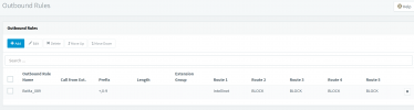

Also please post a screenshot of your Outbound Rules.

Disabled the E164 processing
