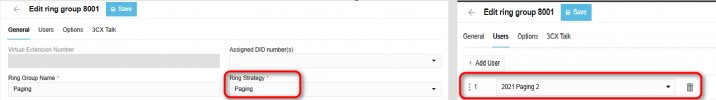

The ATA is correctly recognized and working on the 3CX, I added it to an ext. (see image below)
We tried 2 different ways to make the paging, the 1st one directly calling to the paging extension, it worked but at the end of the sent message it is making a 3 extra beeps like busy signals.
So, we created a ring group using paging where only that ext. will reply the message (see below), nevertheless, the same 3 busy beeps keep occurring.
