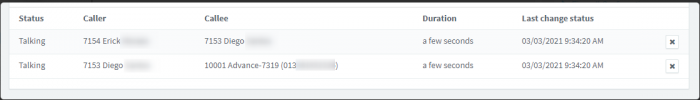

Hi kieferschild,
I made it!
See the print(image)!
10001 Advance-7319 is my SIP trunk.
I think the communications between extensions pass by SIP trunk.
Have as change this?
Check the forwarding rules for that extension, it looks like it's forwarding to wherever.
...or you have "Ring my mobile simultaneously" option enabled.
Had some extensions with this enabled. Mine was one of them. Have 60 extensions, at most 6 were enabled. I disabled. But, i think, have other thing.
The forwarding rules are for extensions.
Perform your test again with that option unchecked and check it isnt going over your SIP trunk
I performed test. No passed per SIP trunk. But, i think, have other thing.
