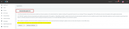

Hi!
The recommendation is to enable the "Automatic update 3CX" option under updates as this also installs OS updates that have been tested with each version of our software you use:
This automatically means that 3CX updates will be installed automatically as well.
This is our recommendation.
From there on, yes, you could install updates by yourself, but we cannot guarantee how the 3CX software will behave with newer versions of the packages you install without updating 3CX too.
