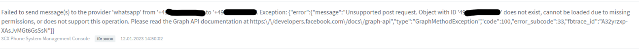

Send works via the Facebook Test API but not via the 3cx.
1673531482565-png.33541
This is the error message delivered to the 3cx from meta.
