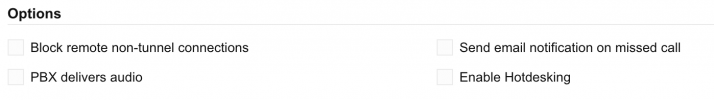

You can enable the "Block remote non-tunnel connections" option. This will prevent them from making calls from their mobile devices, but they will still be able to use the chat feature.
Actually that option blocks connections that do NOT come in through the channel. So an external devices provisioned with STUN.
This is enabled by default to prevent non-secure methods of connection.
