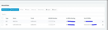

Attached are screen shots of the ring group rules
as well as the SIP
and inbound rules.
