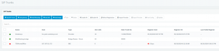

My SBC is showing down for the last 2 days. I had a power outage but the raspberry pi running the SBC is up and running.
1) Is there something I can check on the Raspberry pi?
2) Was there a configuration change that I missed where the SBC is not working with the cloud version anymore?
3) Is there something I can check on my 3CX console to fix this. I attached the SIP information.
Sorry... I am a bit lost here.

Is the Raspberry able to contact the PBX FQDN?
Actually after some additional Debug I found the ethernet port was not receiving or sending traffic. It was providing power to the Raspberry Pi but no network signals. I have ordered a replacement and it arrived this AM... I hope to get this back online ASAP.
