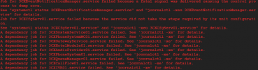

Additionally, you should adapt your instructions to run on a separate server from 3CX, as 3CX policy states that nothing should be installed on the 3CX server.
You simply need to direct the 3CX CDR to another machine instead of 127.0.0.1. Installing the .NET SDK, self-signed certificates, and Git introduces significant risk, as these dependencies might also be used by 3CX and could potentially cause issues with 3CX in the future.
It's not that your solution isn't reliable, but the fact that it uses dependencies that 3CX might also rely on could lead to updates with versions not tested by 3CX.
Potentially causing disasters during a future update. (Image taken from another discussion thread about issues following a 3CX update.)
