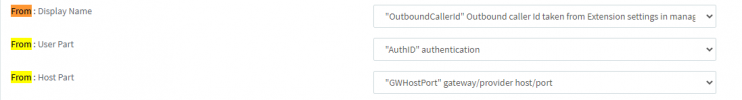

Hi, I have a 3cx installation on Debian 10. The voip trunk is cloudItalia, is a Naked line with 2 numbers, but only one access for it with user and password;
We created the entry rule by selecting the DIDs for each IVR, and everything works. The problem is outgoing, as, although we create the outgoing rule for each numbering, the calls are going out with only one number of that. How can we solve? Yours sincerely

In your SIP settings > Outbound Parameters what have you got set in this field?

Where is the caller ID set on the trunk? Your outbound rule only shows that your calls are using CloudItalia to go out so I am wondering how you have set up your caller IDs. Also CloudItalia only accepts numbers that belong to your account as caller ID so if you are using different numbers it might not work.

Nelle tue impostazioni SIP > Parametri in uscita cosa hai impostato in questo campo?
Scusate se lo so solo ora, ho avuto problemi familiari:
Ecco le impostazioni che ho impostato

You can set your outbound caller ID in multiple locations in 3CX depending on your needs and use case. You can do so at the extension level where every extension can have a different outbound caller ID (or the same). You can set at the trunk level under the Caller ID tab and you can a set a caller ID per outbound rule.
