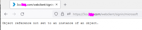

since today we have issues with SingleSignOn
When clicking on Microsoft the following error shows up:
Object reference not set to an instance of an object.

@voip-toni There is something strange going on with your installation, normally the 3CX should send you a 302 redirection to go to the MS login screen, etc, however you are getting a 500 error.
So this most likely means an issue with nignx. I see you are using a Custom FQDN, have you been doing anything with the nginx.conf file?
Another thing you could do is put the 3CX into Verbose, then do another attempt, then open the "3cxManagementConsole.log" and see if that give you any clues.
