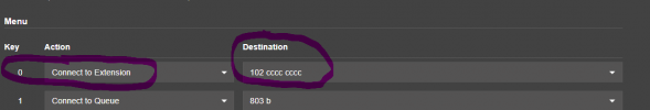

Something like this is set in the Auto Attendant ?:
