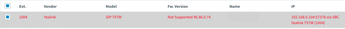

I am confused which firmware version a T57-W as router phone should have. In the router phone page https://www.3cx.com/sip-phones/yealink-t5-series/ it says it should be 96.86.0.74 but in the MC console it currently complains that this phone runs on an unsupported firmware and it should be updated to 96.86.0.76.
I updated it, only to discover that the user couldn't receive or make phone calls anymore. The phone would not register anymore. So I downgraded it back to the .74 version and it works for now.

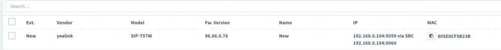

and now I see it like this in the MCM
and the extension won't register
