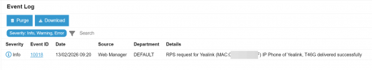

Firstly check the 3CX event log, it should show this after adding a phone:

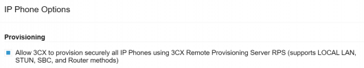

If you see nothing at all, then you probably turned off this setting:
-The phones do not generate any RPS related logs. I have turned on the phone provisioning setting you mentioned and this did not make a difference.
So you had it disabled..
I am not sure what you mean, toggling the settings didn't change anything. Even with the settings set to off other phones auto provision and generate RPS logs, I tested with other Yealinks and Grandstream phones and they auto provision. The problem only exist on the units that I requested MAC RPS removal from Yealink.
Nope, that specific message I shared will exclusively appear only when that option is enabled. What you are seeing are probably provisioning logs that say Provisioning file for MAC xxxxx was successfully generated, they don't have the word RPS in there.
Impossible if the option was off - it must have been on at the time of provisioning I would surmise. Were you perhaps provisioning via PnP which does not use RPS?
That's why I shared that specific screenshot with that specific text in it. Now that you have enabled the option in 3CX, please delete and then re-add your phone, then check for that particular message I shared. You might get a different message informing you that it was not added, and why (reply coming back from Yealink's RPS servers).

Follow JohnS' instructions: check the box, delete the phone in the user, save the change, and add the phone again. (Only in the 3cx UI).
Check the 3cx event log for rps messages.
