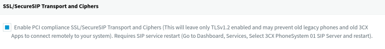

What you can do:
a. On the local LAN you can switch off the need for TLS 1.2 and other security checks/options in the security section in the management console. If you have your phone system properly protected by a firewall you are reasonably safe. If its on the cloud you can not use this option as you will get hacked.
b. Other way is to use manual provisioning. This should be fine because there are no new firmwares for this phone so there is no need to update it from the console. But yes options such as BLF are not easily configurable anymore.
To be clear any EOL decision is made by Yealink, not by us. We fully understand its unfortunate that phones such as 46G/48G can not be used as before. We are not party to the decision why a new firmware can not be released but I am sure there are good reasons for it.
What you can do:
a. On the local LAN you can switch off the need for TLS 1.2 in http provisioning in the security section in the management console. If you have your phone system properly protected by a firewall you are reasonably safe. If its on the cloud you can not use this option as you will get hacked.
To be clear any EOL decision is made by Yealink, not by us. Although we are in almost daily contact with Yealink we have reached out one more time to clarify their position to be 150% sure.
And no one, certainly not 3CX, is stopping you from contacting Yealink directly and asking for their clarification.

Just to note that the T42G, whilst also EOL, also supports TLSv1.2. Our 3CX 18U5 has the Enable PCI compliance ticked, and tests show the web interface now only has TLSv1.2 enabled (i.e. that it does not answer the provisioning URL on either TLSv1.1 or TLSv1.0).
Phones with the most recent firmware (29.83.0.130 for the T42G) still provision correctly even after a factory reset.
Phones with older firmware (we had one in a box with 29.76.x.x) fail to provision, presumably because it does not actually support TLSv1.2 (release notes say it was introduced in 29.81.0.70). However, if we manually update the firmware to 29.83.0.130, they can also provision themselves.
I have just updated to U5, and so far find no issues with our T46G phones. They re-provision and reboot etc from the phones menu on the admin portal. We are using 28.83.0.130 firmware and the security.default_ssl_method = 5 option to enable TLS 1.2. CTI control works from the windows app. Haven't tried factory reset to provision from scratch but for an already provisioned phone I can't find any problems so far which is good news.
I'm assuming the provisioning is happening via local LAN and not SBC? And it's likely using a http link, not https?

Yes local LAN as per your screen shot above
