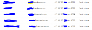

Thank you for the message, Please see below, I have the following info in Teams
As you can see its correctly setup. However the users are missing their dialers

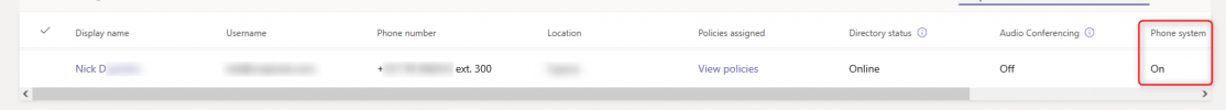

Do they have the Phone system license flag?
[EDIT]
One more thing you could try, instead of logging in with the Teams Desktop App, try the Teams Webclient
[EDIT]

Please see below, I have made sure that the correct licensing has been purchased.
I have asked the client to login to teams on their browser to see if the dialer is there.
Will let you know.
