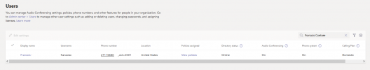

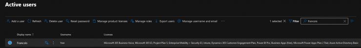

Hi Stefan! Thanks for the troubleshooting advice and your feedback on my thread.
The 365 user in question doesn't have a Microsoft 365 Phone System license assigned, but we however do have MS Office E3 and MS Business Voice as seen in my attached screenshots.
Please let me know if you have any questions or troubleshooting tips.
Kind Regards

If you have business voice, you have calling plan by default turned on.
Calling plan must be disabled for you to set direct routing for a user.
I'd recommend you get rid of business voice and get just phone system and audio conf. That's $12 USD standard vs $20 for Business Voice. But if you want to keep Business Voice, you must disable calling plan in the license tab of 365.
Would you be so kind to post me a screenshot where the user can disable the calling plan in order to add it to the documentation. Thank you in advance
I don't think you can "disable" the calling plan. AFAIK, it's based on the license. You can have a "Business Voice" or "Business Voice without calling plan".
Here you go:
This is done from the 365 Admin Portal (admin.microsoft.com for most) for each user. You can also do it from the Azure portal depending on your setup.

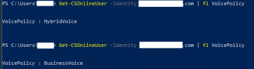

To provide further information
If you run
Code:
Get-CSOnlineUser -Identity [email protected] | fl VoicePolicy
You will either get:
HybridVoice
OR
BusinessVoice
You cannot do direct routing with BusinessVoice and that will cause an error like above.

@SweetAction thanks for your assistance! Disabling the "Microsoft 365 Domestic Calling Plan" resolved my direct routing problem.
Kind regards :)
