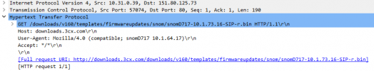

Hi Corey,
I manually downgraded a D717 to the version you mentioned.
I then provisioned it in a SBC-based V16.0.8.9 PBX and proceeded to upgrade the firmware as you would normally via the management console.
In my case, the D717 downloaded the file immediately and the upgrade was successful.
Below you can see the requesting phone stating its current firmware, and the plain HTTP URL it used to download the file
