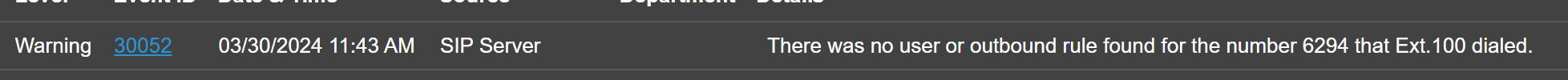

I don't understand how this works. I see the problem in the logs, it does not process the found record as an extension, but instead uses the keys entered when searching for the name (see attached picture). Screenshot 2024-03-30 115202.png
There does not seem to search and select a contact.
Check on the process as it does show that you validate a contact but just pressing digits and transfer.
What is there to check? You key in the name, select the right person from the list, and press Xfer. What am I missing?
From the provided screenshot it does not show this but instead a number dial and forward to this number.
