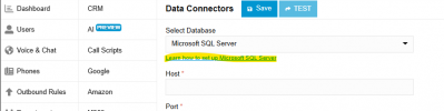

If you go to the Integration > Data Connectors page and select MSSQL you'll get a link to help you with the set up.
