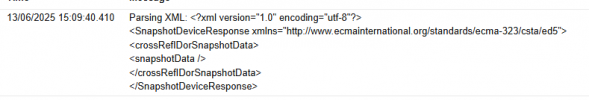

I was playing with the verbose mode within the activity log and saw many entries with this:
If I open that link it a browser I get redirected to different dodgy websites. Any ideas what this could be?

Hi Pierre, thank you for your reply. I have contacted Yealink too now. It is very weird. I get two different links; one does not seem genuine.
Code:
http://www.ecma-international.org/standards/ecma-323/csta/ed5 (this one seems ok)
http://www.ecmainternational.org/standards/ecma-323/csta/ed5 (this one is definitely wrong)
Green one seems ok, red one redirects to unsafe websites and I have no idea why or what these links are for or what they do.

I got a reply where they first said that the links were normal.
This is a normal info message, used to report the current status of the device. This domain name is to inform you that the current status of the phone and service is reported based on the CSTA standard defined by the European Computer Manufacturers Association.You can consult the servicer provider for details.
When I asked them to take a second look as the links were different they asked me to check with my provider.
Yes, you are right. The content of the two links is different. The first one looks normal. As for the second one, you can ask the service provider.
I have asked our service provider.
