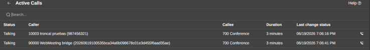

Hi @Marco@ could you please elabore more your question. I tested on my side and it works ok using SP9 version 20.0 Update 9 (Build 995 Release - AI 1.4.48)
  • Participant list displayed correctly for those that joined by dialing in 1781907009924.png

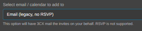

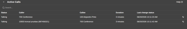

@Marco@ I tested with an audio conference and it works too but try it using the option Email (legacy, no RSVP)
The external participants are listed as you may notice in my screenshots.
It works for audio and webmeeting conferences...

Ahh indeed, it seems to only work using Email / LEGACY. - When using Email/Calendar option of say Google, it does not. Was this by design, ahs this always been that way? I don't recall.
