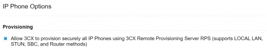

Check and enable this option if not enabled:
Admin Console > Phones > Options > Allow 3CX to provision...
Then delete and add the device again. Check the event log after a few seconds. You will see a success message, or you will see a failure message after a couple of minutes if there was an issue. If its ok you may reboot the phone and wait a few minutes for it to provision.
By the way, you can also assign the phone from the PNP tab if you have a SBC or the phones are local. If they are not local, an SBC is 100% required so keep that in mind before you proceed.
Reactions: GMCS
Bingo. I have a SBC here, and i went right to the PNP tab and their it wsa. Soon as I hit that, it updated the phone and set. Super simple. I also didnt have "Allow 3cx to provision...", i enabled that first.
