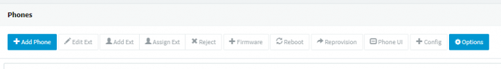

No need to return the phones. They appear in red because the system has a newer firmware downloaded, and the phones are not currently using it.
Select any phone that is red, then click the firmware button on top.
The system will upgrade the firmware for you to the correct version.
Reactions: teagle
Under Phones - select the phone and click on Firmware along the top
Thanks John! Worked perfectly! Hopefully I can now adjust the necessary settings for the user! Thanks again.. :)
