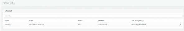

When this should happen, on V.18 i see the call stays stuck on Initiating and never moves to "Routing" status (i can wait one hour and it stays there, filling concurrent calls until there are no more).
3CX active calls:

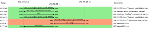

Wireshark:

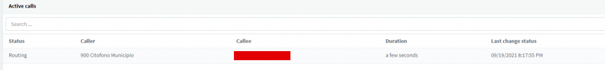

3CX active calls:
Wireshark (looooonger):

Hi Alberto,
Can you replicate the problem if you make a call to the ring group using a supported device?
If yes, I would like to see that capture.

It looks like an incompatibility between your 2N doorphone and the T23G.
You have two options so it can start working again in V18:
a) disable the video on the doorphone entirely if you don't need it - problem solved
OR
b) use sendrcv Attribute for Video - problem solved
Reactions: alberto.azzini
I confirm it is working correctly now (I used option 2). Thank you!
