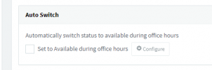

Likely some sort of dummy extension with time based rules and forwarding to the correct areas.
Combine with times on the inbound rule if you want.
So first 2 would be handed by dummy extension with time autoswitching:
Last rule would be on the inbound rule itself:
