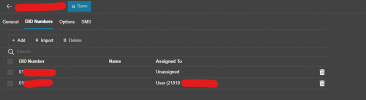

This is my SIP Config:
Then under DID numbers I've listed all the other extensions as you can see the other number is assigned to 21010 not 21011, yet it still rings 21011....
I've also changed the default route and it just does the same, but to a different extension...
Thanks

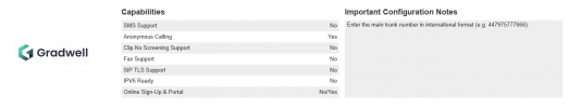

On our site, in the details for each provider, Gradwell is listed as needing 44XXXXXXXX so try adding them into that format, without the + and definitely not in National format beginning with 0
My god I can't believe it - that was all it was. xD
I tried +44 and 01 and no luck and it was a + that was stopping the whole thing from working.....
Thank you so much Nicholas!
