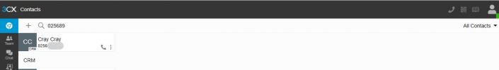

Successfully integrated Hubspot with 3CX and call logging works just fine.
Contact Creation, however, visibly only saves the contact name.
I would expect the "Phone Number" field to be saved when saving the contact from 3CX but it doesn't and agent have to do it again manually.
Is there something I'm missing or could do to resolve this?

Use the "Mobile" field in the popup to create the contact.

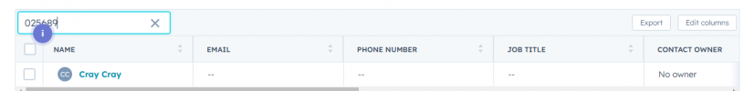

On 3cx, yes, it shows. Hubspot retrieves the associated contact alright but the phone number field isn't filled.

Find what field the saved number is mapped to
In my case it was "PhoneMobile" so I went back to the Contacts Page in Hubspot to add the Mobile Phone Number column and sure enough, the numbers were saved there.
